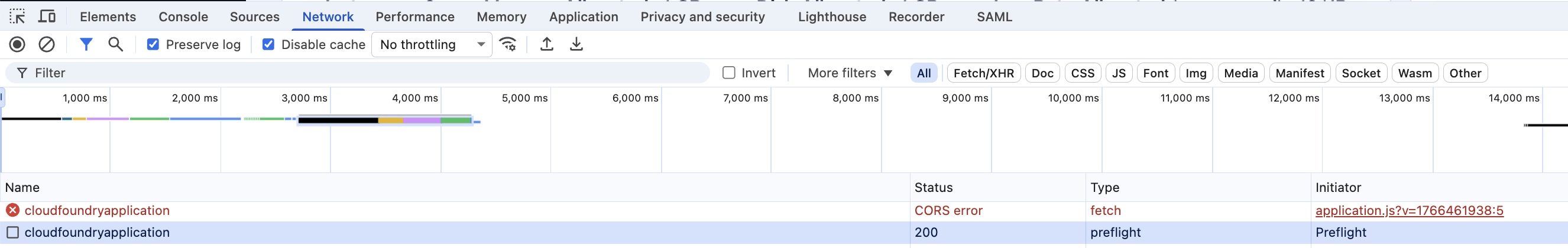

When deploying a Spring Boot 4.x application to Tanzu Application Service (TAS) and accessing it through Tanzu Apps Manager, actuator-based information (health, metrics, etc.) as explained in https://techdocs.broadcom.com/us/en/vmware-tanzu/platform/elastic-application-runtime/10-3/eart/spring-boot-actuators.html fails to load.
Browser developer tools show a CORS error in the "/cloudfoundryapplication" request as shown in below screenshot:
