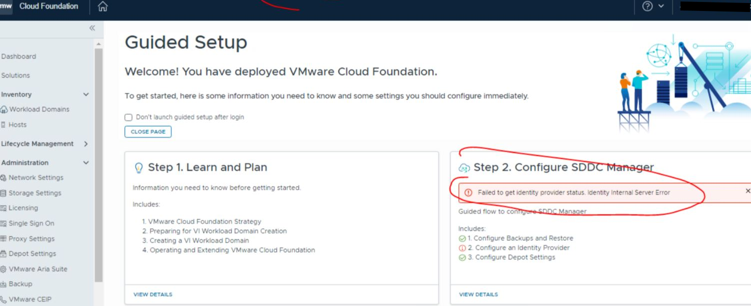

Additionally, SDDC manager shows below error:
