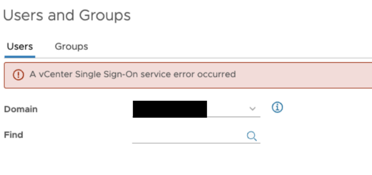

In vCenter, when accessing Users and Groups from the admin SSO login, the following error is displayed: 'A vCenter Single Sign-On Service error occurred.'

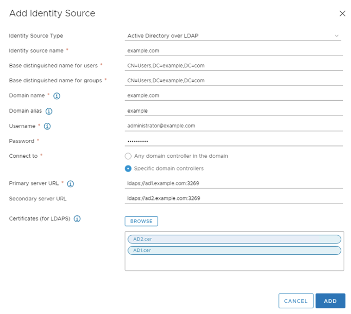

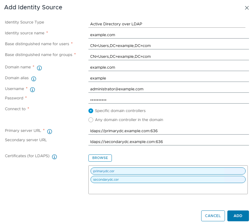

If the Active Directory (AD) service account used for the Identity Source becomes locked, disabled, or has an expired password, AD user logins to vCenter will fail.
To resolve this issue, follow the steps below
Note:
