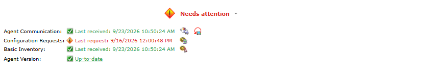

When you check the current status on this machine in the SMP Console:
the Configuration Requests has an alert, but with communication and plugins are up to date.
