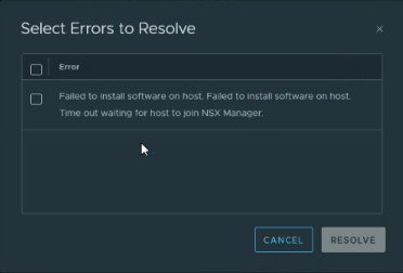

Error: "Time out waiting for host to join NSX Manager" at 48% during NSX host preparation.

  • In the NSX Manager UI, we see the error:
    "Failed to install software on host. Failed to install software on host. Time out waiting for host to join NSX Manager."
  • Removing the host from the cluster and re-adding it results in the same failure at 48%, even if the NSX status initially shows "Not Configured."
