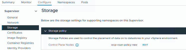

After following the KB#385016 to apply a new storage policy to the supervisor cluster, it's not working properly as expected.
Only the "MasterStoragePolicy" was changed.
# ./wcp-db-dump.py |grep -i storage
          "ImageStorage": {
            "StoragePolicy": "eabeb5ff-####-####-####-########" <------------------- Old Policy
          "MasterStoragePolicy": "bc4464e9-####-####-####-########",  <------------------- New Policy
          "EphemeralStoragePolicy": "eabeb5ff-####-####-####-########" <------------------- Old Policy
Check the UI, there is only one option for control plan node, not for "Image Storage Policy" and "Ephemeral Storage Policy"
