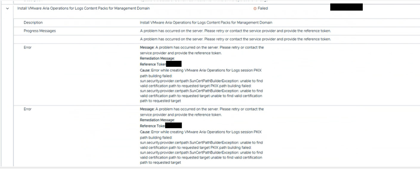

Task: Install VMware Aria Operations for Logs Content Packs for Management Domain
Status: Failed
Description: Install VMware Aria Operations for Logs Content Packs for Management Domain
Progress Messages: A problem has occurred on the server. Please retry or contact the service provider and provide the reference token. A problem has occurred on the server. Please retry or contact the service provider and provide the reference token.
Error Message: A problem has occurred on the server. Please retry or contact the service provider and provide the reference token.
Cause: Error while creating VMware Aria Operations for Logs session PKIX path building failed: sun.security.provider.certpath.SunCertPathBuilderException: unable to find valid certification path to requested target PKIX path building failed: sun.security.provider.certpath.SunCertPathBuilderException: unable to find valid certification path to requested target unable to find valid certification path to requested target
