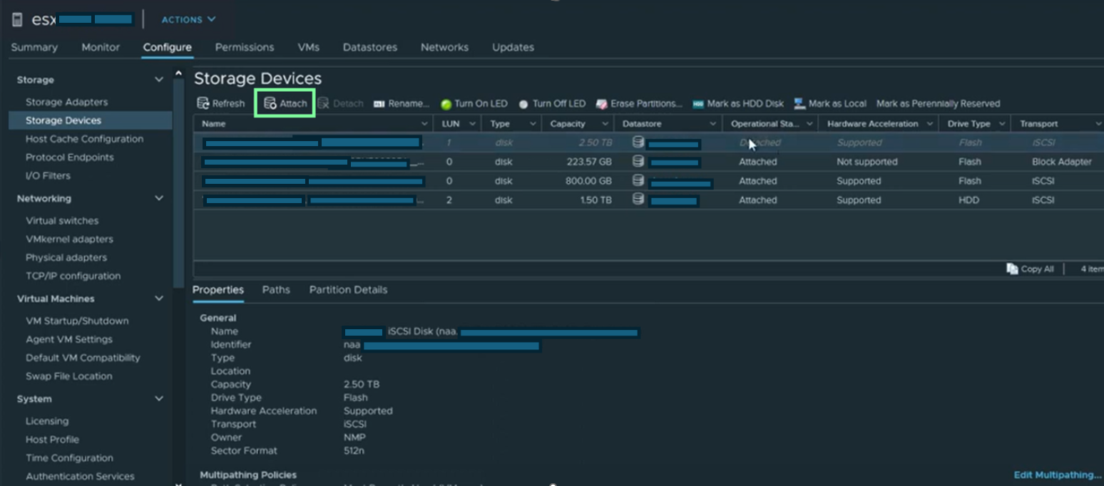

  • To reattach the LUN from  the direct Host Client:
         Host  ---> Configure --> Storage Devices --> Select the correct backing device naa id --> Attach.
  • Alternatively, can reattach the LUN by executing the following esxcli command on each affected ESXi host.
    esxcli storage core device set --state=on -d naa.#########################
  • Post running the above command the Devices capacity should be shown correctly.
