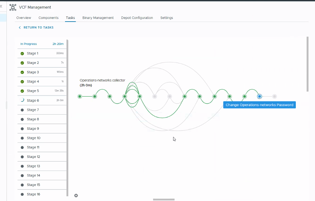

  • While deploying VCF Operations for networks, the Fleet manager (vRLCM) is stuck on stage 6 - "Change Operations-networks Password
    Refer to screenshot below which shows that the deployment is stuck/hung at stage 6.
