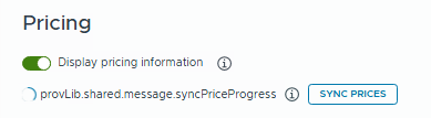

  • Accessing the VMware Aria Operations integration within the VMware Aria Automation Assembler UI (under Infrastructure > Integrations), the SYNC PRICES task never completes and shows the status provLib.shared.message.syncPriceProgress
  • Executing a GET API call against the VMware Aria Operations integrations endpoint (https://<Aria-Automation-FQDN>/iaas/api/integrations/<INTEGRATION-id>?apiVersion=2021-07-15) returns the status of "lastRunningPriceSyncStatus" as "IN_PROGRESS".
