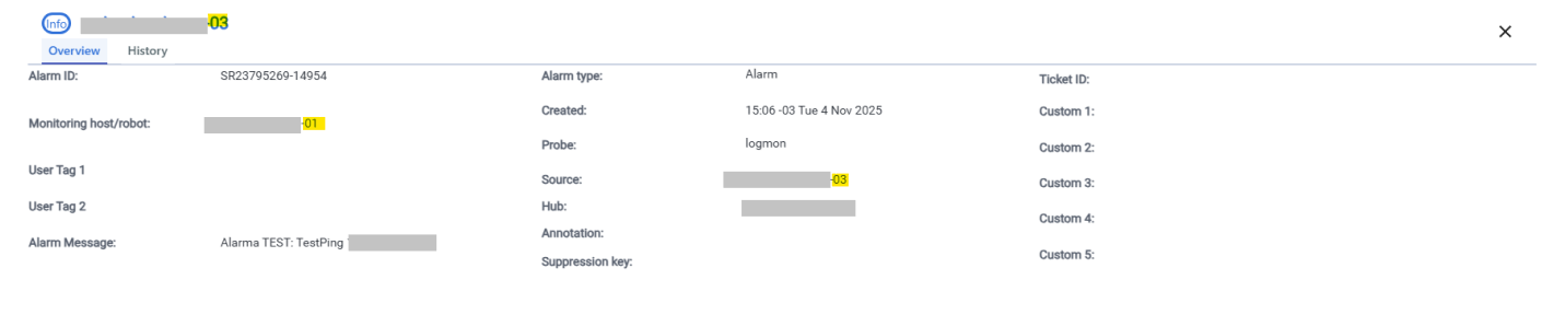

Logmon probe Alarms are not associated with the correct device when "Update Alarm Source as Device" is enabled.
