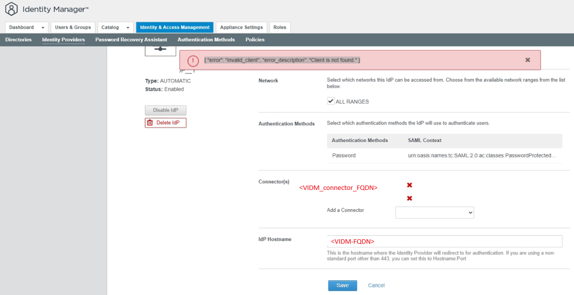

  • Attempts to add the vIDM connector under Identity Providers fail with the following error: ["error": "invalid_client", "error_description": "Client is not found." ]
