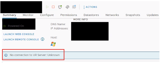

Symptoms:
  • Legacy replication for VM goes to Not Active state with the error message displayed below:
    A replication error occurred at the vSphere Replication Server for replication '####-#####'. Details: 'No connection to VR Server for virtual machine #####-#### on host ####.###.###.## in cluster ####.####.####.## in #####-######: Not responding'
  • The virtual machine summary page displays the error "No connection to VR server: Unknown".
