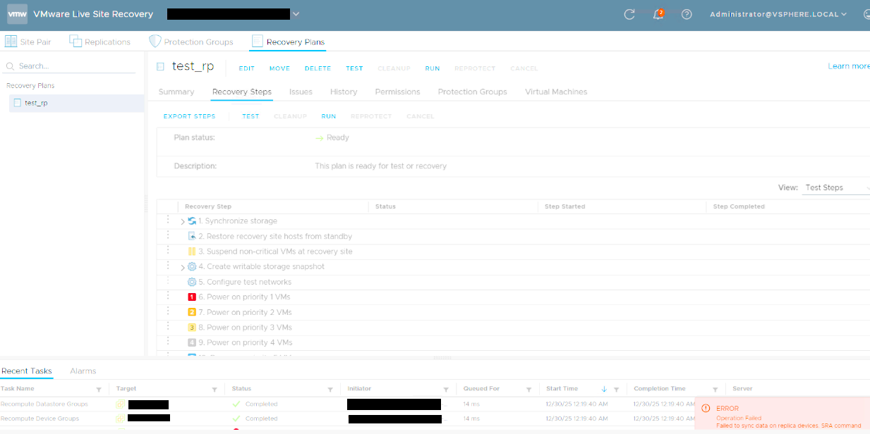

  • During a reprotect operation in VMware Site Recovery Manager (SRM) using PowerFlex Storage Replication Adapter (SRA), the reprotect task fails with the error:
Failed to sync data on replica devices. SRA command 'syncOnce' failed. General error, check logs for details.
  • Though the reprotect task reports errors, the replicated datastore mounts correctly on the recovery site.
