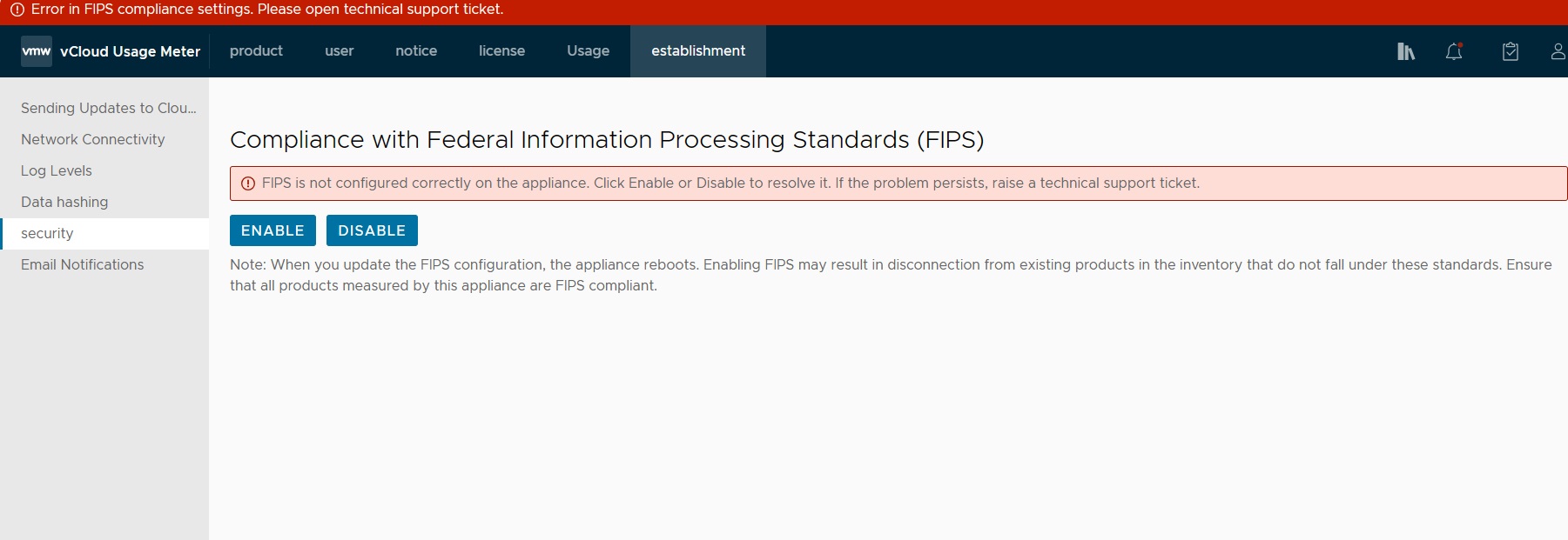

Symptoms:
  • Following message is displayed on security tab in Usage Meter UI
FIPS is not configured correctly on the appliance. Click Enable or Disable to resolve it. If the problem persists, raise a technical support ticket.
  • Clicking "ENABLE" and "DISABLE" does not work
