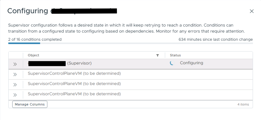

  • A vSphere with Tanzu Supervisor Cluster remains in "Configuring" state in the vCenter UI, and one or more SupervisorControlPlaneVMs appear as “to be determined.”
  • During this condition, Tanzu control-plane services could not complete initialization, putting Supervisor and workload management operations at risk.

  • The "vmware-trustmanagement" service on vCenter Server is found to be in stopped state.
    • This service exposes identity and trust-related APIs that WCP relies on to complete its compatibility and environment checks
    • With vmware-trustmanagement down, calls to /rest/vcenter/identity/vc-identity returned HTTP 503, causing WCP reconciliation to fail and leaving the Supervisor in Configuring state.
