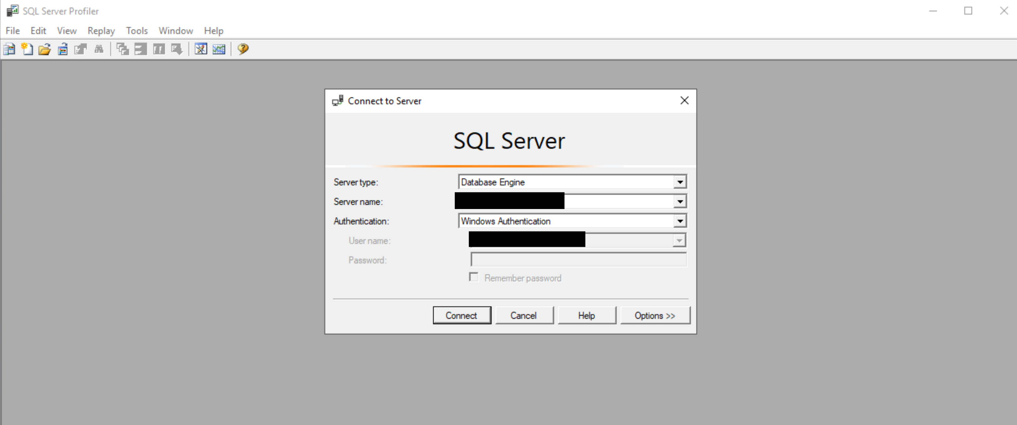

For MS SQL, SQL Server Profiler can used to record the statement.
File > New Trace
Connect to the Database server where Automic is hosted
Hit run to start recording
Hit stop once ucdbconntest  is done running.
Hit File > Save As > Trace File.

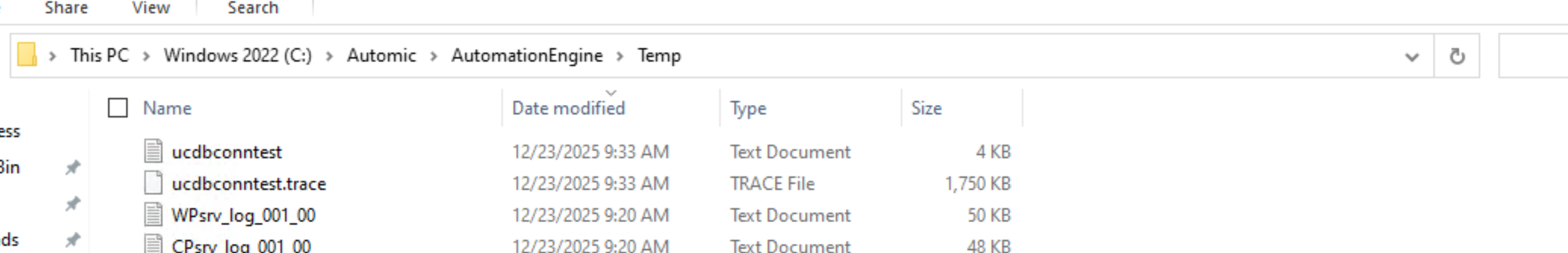

The standard trace can be generated by this command from the Automation Engine bin directory.
ucdbconntest.exe -T2
If successful, it will first generate some information about the database, then it will generate 2 files in the Automation Engine temp directory.
The two files are named ucdbconntest.txt and ucdbconntest.trace
The ucdbconntest.trace is the most important part. It not only gives us information about the database but also about the time stamps of each query that we will need to compare with the database side. This is the application side for the DBA to refer to.
