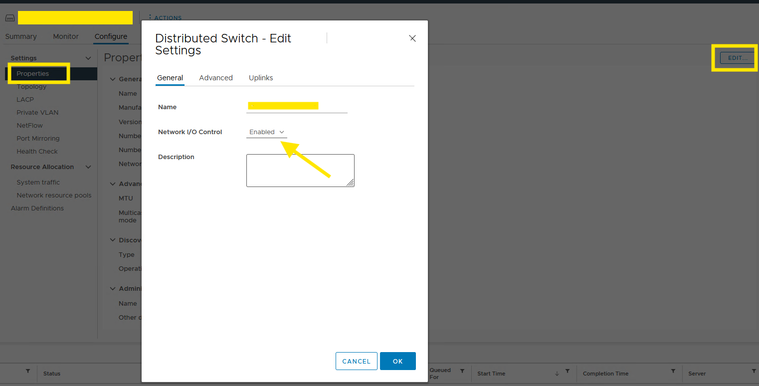

  • Log in to the vSphere Client.
  • Navigate to the Inventory and select the destination Distributed Switch.
  • Click on the Configure tab.
  • Under Settings, select Edit.
  • Set the Network I/O Control status to Enabled, then click OK.
  • Retry the virtual machine migration or PowerOn task.
Below is the screenshot for your reference
To know more about Network I/O Control, please refer to the documentation --> What is vSphere Network I/O Control
