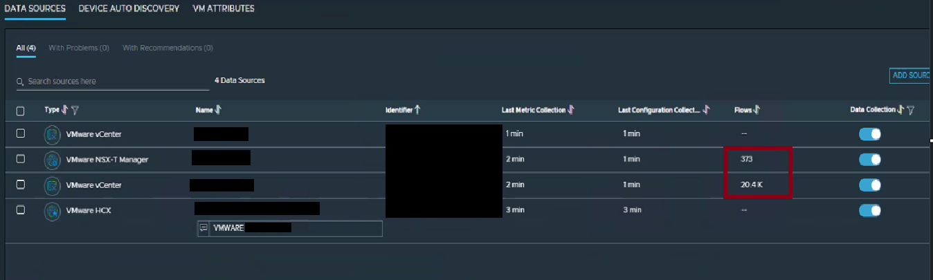

  • Under Settings>Accounts and Datasource page we see that vCenter and NSXT datasources are added and we see the flows numbers as well.
    See screenshot below showing flow numbers:
