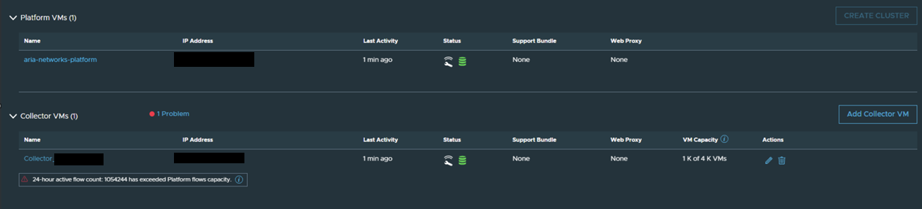

  • Alert seen on GUI System usage has breached capacity for Active Flows.
  • Platform Capacity shows Active flows capacity breached.
  • Collector on UI also shows the flow capacity error.
    Error screenshots from UI as below:
  • VCF Operation for Networks 6.13.0
  • VCF Operation for Networks 6.14.0
  • VCF Operation for Networks 6.14.1
Both Platform and Collector are running Medium Brick size due to which the usage of active flow has breached capacity of 1 M flows on appliances.
