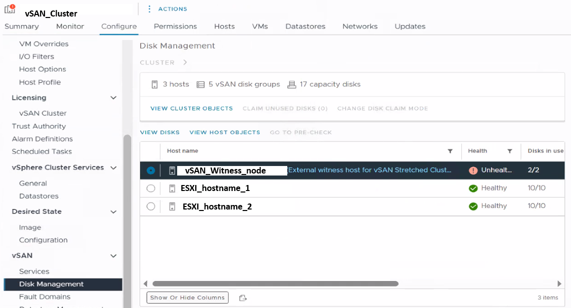

The issue is noticed on a two-node stretched vSAN cluster.
The following error is observed on the vCenter task manager.

The issue is caused by a disk failure or disk performance degradation on the physical host where the vSAN Witness VM is running. This condition results in stuck I/O on the witness node disk, causing the disk to be marked offline and unhealthy.

Perform one of the following actions:
Reboot the vSAN Witness VM to clear the stuck I/O condition.
Delete and create the disk group on the witness host ,in case the disk group shows as unhealthy even after performing the reboot of the witness host .
Migrate the witness node VM to a different datastore that is not affected by disk performance issues and then check the health of the witness node .
Additionally, work with your storage administrator to identify and resolve the underlying disk or performance issue on the physical host hosting the witness VM.
