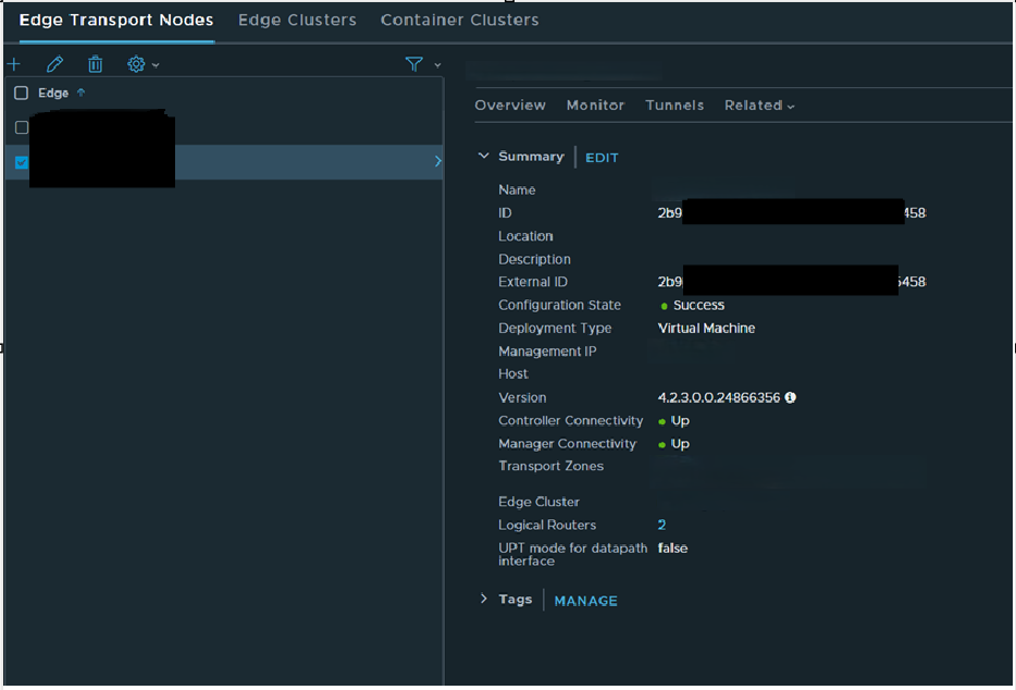

  • A mismatched NSX Edge Node ID within the NSX/SDDC configuration led to the failure of migration operations when updates were applied to that node.
  • Note that re-deployment of an NSX Edge Node can introduce inconsistencies into the overall NSX/SDDC configuration.
This resolution requires manual changes to the SDDC Manager database. Please contact Broadcom Support for assistance.
