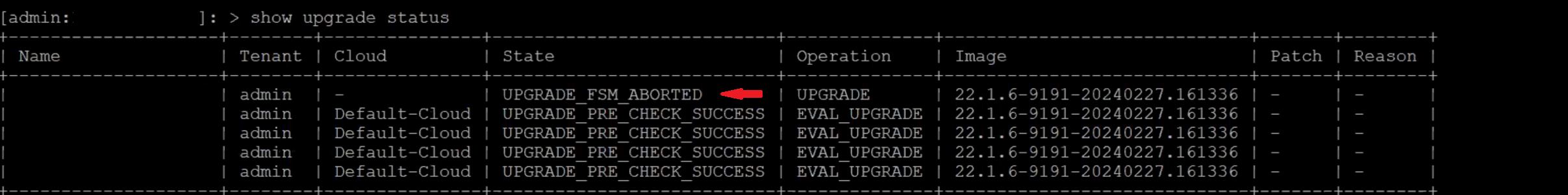

The following behavior is observed:

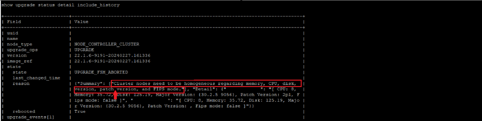

  • Upgrade status shows UPGRADE_FSM_ABORTED
  • Error indicates ["Cluster nodes need to be homogeneous regarding memory, CPU, disk, version, patch version, and FIPS mode."]

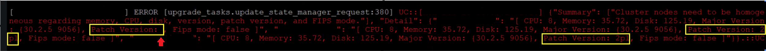

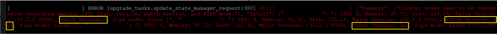

  • The patch is applied on the leader and follower nodes, but one follower node reports the patch version as Empty, resulting in a patch version mismatch across the controller cluster.
  • Errors are logged in /var/lib/avi/log/upgrade-coordinator.log on the Controller Leader node (check both current and previous partitions).
  • Due to this mismatch in patch status across controller nodes, the upgrade does not complete.

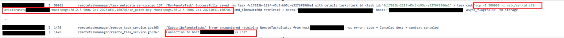

  • Patch image transfer from the leader to one follower controller node fails due to a connectivity interruption.
  • The patch package on the affected follower node remains incomplete or corrupted.
  • The connection lost between controller nodes during patch image transfer is logged in /var/lib/avi/log/remote_task_manager.INFO on the Controller Leader node.

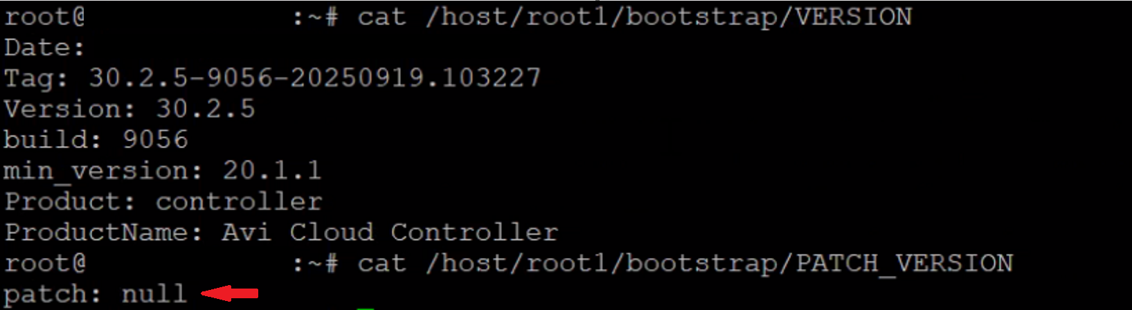

  • After the controller upgrade fails, identify the controller node where the patch version shows as empty by reviewing /var/lib/avi/log/upgrade-coordinator.log
  • Log in to the affected controller node and verify the patch status in the old partition; if the patch version shows as null, the patch is not applied.
