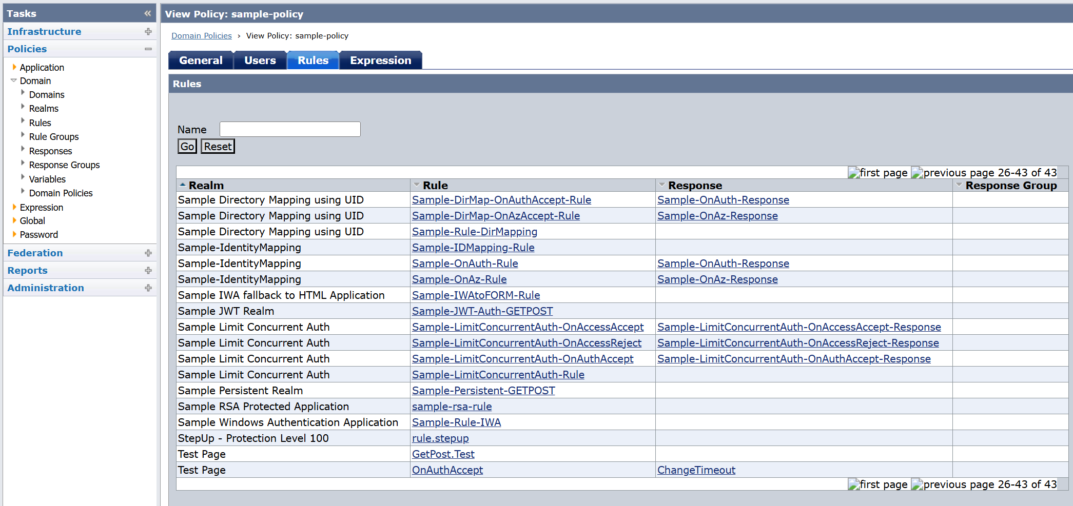

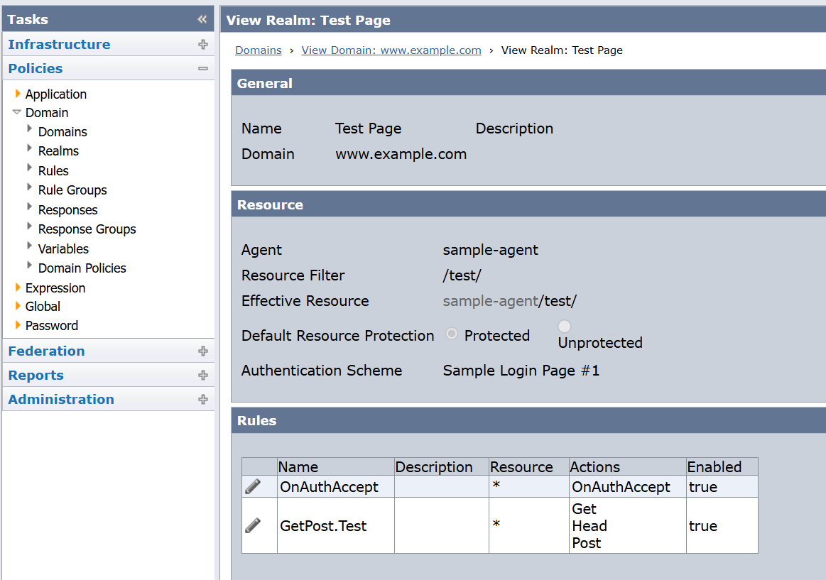

Create a changetimeout response using "WebAgent-OnAuthAccept-Session-Idle-Timeout" and/or "WebAgent-OnAuthAccept-Session-Max-Timeout" and associate the response to OnAuthAccept rule for that realm in the Policy settings.

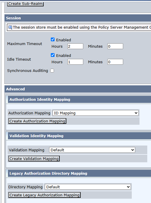

When you have Identity Mapping configured in a realm, you also need to configure the Auth-Validate mapping on that same realm as well.
For example,  there is "AuthDir - ID Mapping" for authentication and "AuthorizationDir - ID Mapping" for authorization.
Then the "ID Mapping" is configured as below.
It is "Auth-Az" mapping.
And the mapping is associated to the Realm.
And configure OnAuthAccept rule + change timeout response as above.

Engineering instructed the following additional configuration which is to create "Validation Identity Mapping" as well and associate it in the same Realm.
Now add the "Auth-Validate_id_mapping" to the same Realm configuration.
This ensures the Authentication Directory's OID and the Authorization Directory's OID to match so the OnAuthAccept+Response did get triggered which updated the MaxTimeout.
