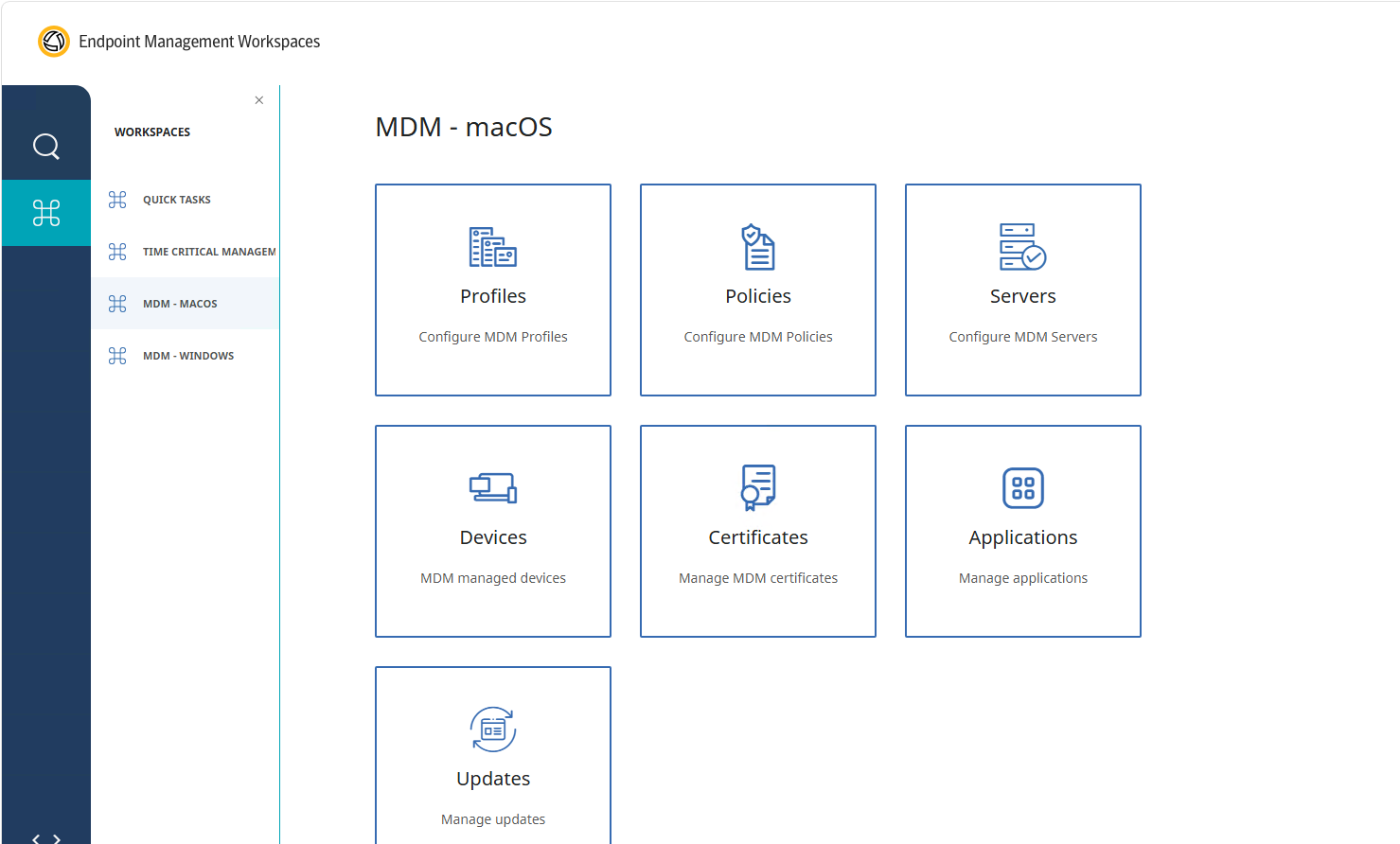

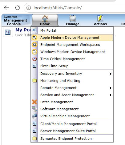

To get to the main MDM - macOS configuration pages, on the SMP Console, go to Home > Apple Modern Device Management

How: MDM - macOS > Certificates in the SMP console. Look for an entry with category APNS.
