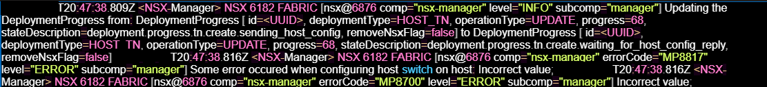

  • NSX manager syslog may have the following log entries:
  • 2025-12-11T20:47:38.809Z <NSX-Manager> NSX 6182 FABRIC [nsx@6876 comp="nsx-manager" level="INFO" subcomp="manager"] Updating the DeploymentProgress from: DeploymentProgress [ id=<UUID>, deploymentType=HOST_TN, operationType=UPDATE, progress=68, stateDescription=deployment.progress.tn.create.sending_host_config, removeNsxFlag=false] to DeploymentProgress [ id=<UUID>, deploymentType=HOST_TN, operationType=UPDATE, progress=68, stateDescription=deployment.progress.tn.create.waiting_for_host_config_reply, removeNsxFlag=false] 2025-12-11T20:47:38.816Z <NSX-Manager> NSX 6182 FABRIC [nsx@6876 comp="nsx-manager" errorCode="MP8817" level="ERROR" subcomp="manager"] Some error occured when configuring host switch on host: Incorrect value; 2025-12-11T20:47:38.816Z <NSX-Manager> NSX 6182 FABRIC [nsx@6876 comp="nsx-manager" errorCode="MP8700" level="ERROR" subcomp="manager"] Incorrect value;
