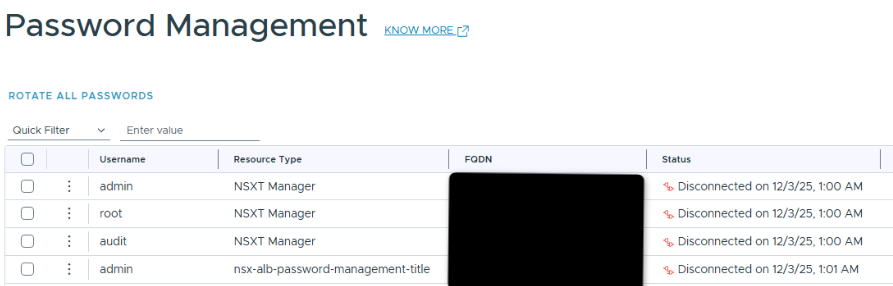

  • NSX ALB password shows a "disconnected" status in SDDC Manager under Password Management:
  • The password being used to login to AVI matches what SDDC Manager has in its database and we are able to login successfully to the AVI UI with the credential
  • Attempting to remediate the password to re-sync the account back to SDDC Manager fails with error "Failed to update user credential in AVI Load Balancer Controller Cluster
