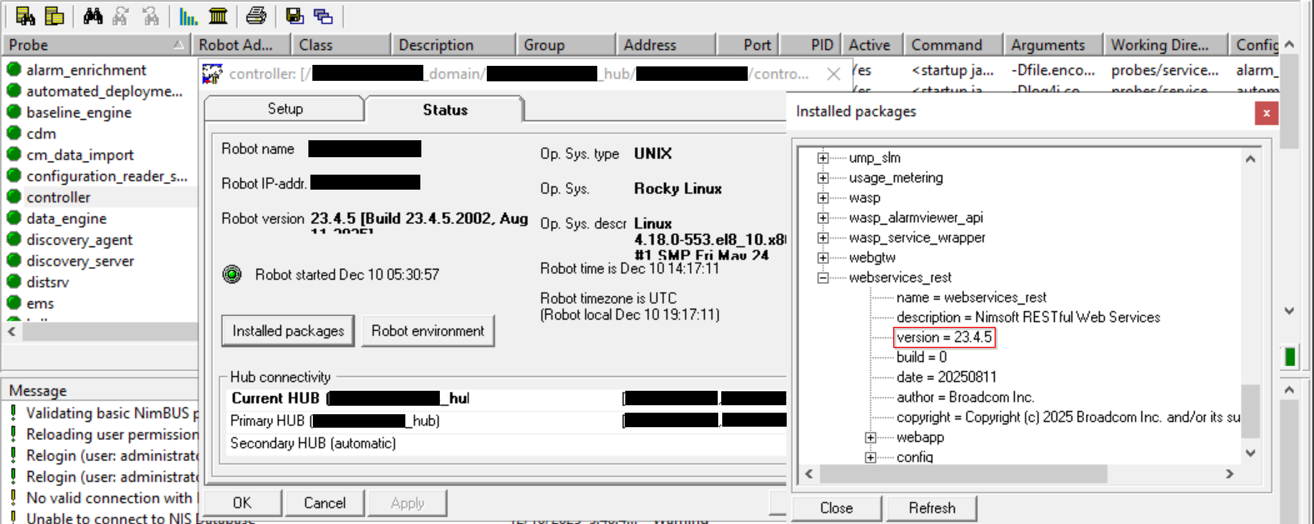

The webservices_rest version is aligned with the DX UIM version. It can be found in the "Installed Packages" button of the controller probe.
The webservices_rest version can also be viewed at this endpoint:
http://<IP or hostname of OC>:<port>/rest/version-info

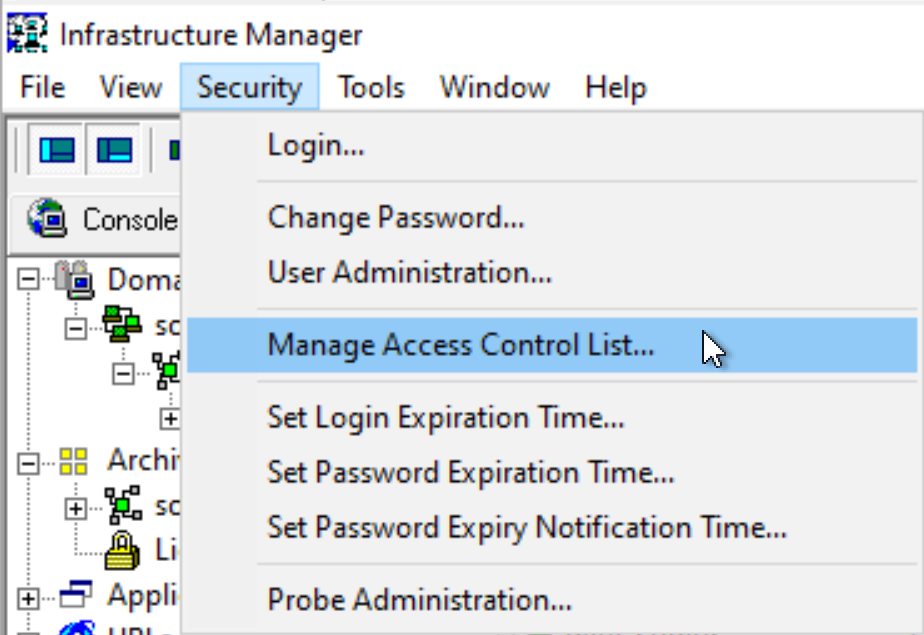

 Open Infrastructure Manager:
> go to: Security
> "Manage Access Control List..."
> and select the ACL assigned to the affected user
> Enable the "Web Service" ACL
