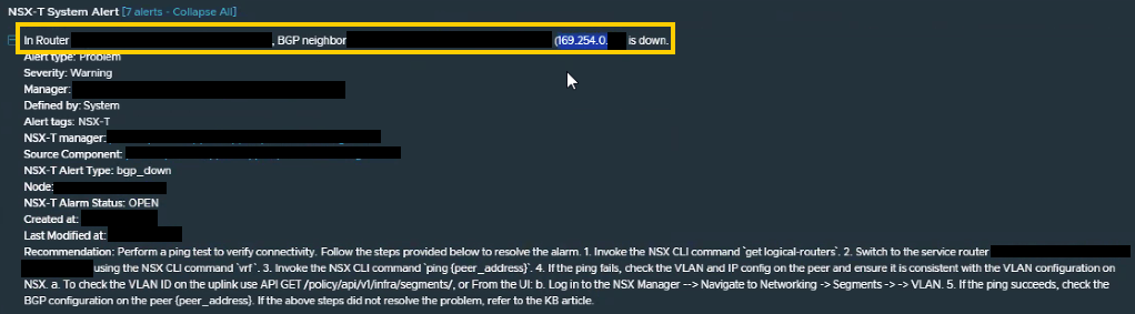

  • BGP down alarms are observed in VROPs, but no issues or BGP errors can be seen in VMware NSX.
  • The referenced BGP IPs belong to the 169.254.0.X Range.
  • Inter-SR BGP is enabled within the NSX T0 configuration.
  • No alarms are seen in NSX GUI for BGP.
  • When checking NSX for open alarms via API the same alarms can be seen in an open state when checking with the below NSX APIs.
    • GET /api/v1/alarms?status=OPEN
  • If the open alarm for the Inter-SR BGP is set to resolve via API, it will re-trigger the alarm with a new alarm ID immediately.
  • Alarm similar to the below are observed in VCF Operations / VROPs:
    • BGP Neighbor down has been observed on <Collector ID>
    • In Router 5151XXXX-XXXX-XXXX-XXXX-XXXXXXXX46bf, BGP neighbor 470fXXXX-XXXX-XXXX-XXXX-XXXXXXXXf0ba (169.254.0.X) is down."
