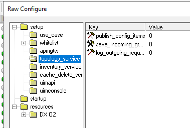

1) open apm_bridge raw configure
2) go to setup > topology_service
3) Set all values = 0
Eg:
 <topology_service>
      publish_config_items = 0
      save_incoming_graphs = 0
      log_outgoing_request = 0
      enableNewVertexIdFormat = false
   </topology_service>
