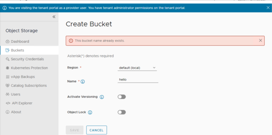

Users are unable to create buckets in Tenant Object Storage Extension (OSE). The UI reports the error:
“This bucket name already exists.”
However, backend logs indicate an S3 authorization failure rather than an actual name-conflict issue.
