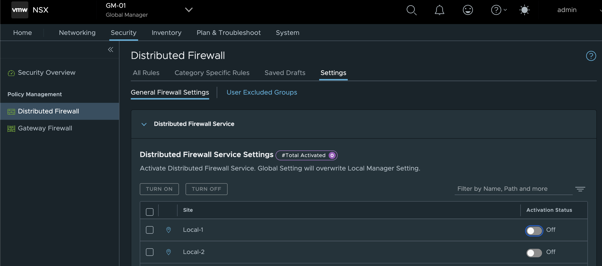

  • Disabling the DFW service from the Global Manager UI, may not be reflected on some Local Manager sites.
    (Security → Distributed Firewall → Settings → General Firewall Settings)

    • The NSX UI shows DFW status as disabled.

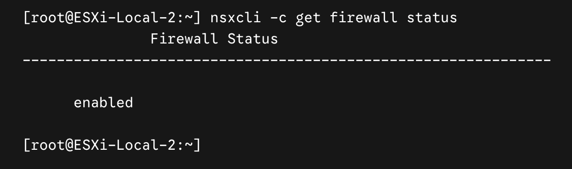

    • ESXi hosts continue to report DFW as enabled.
  • Running the following command on the ESXi host, shows that the Distributed Firewall is still enabled.
    " nsxcli -c get firewall status "
  • This indicates a mismatch between the NSX Manager configuration and the actual host state.
