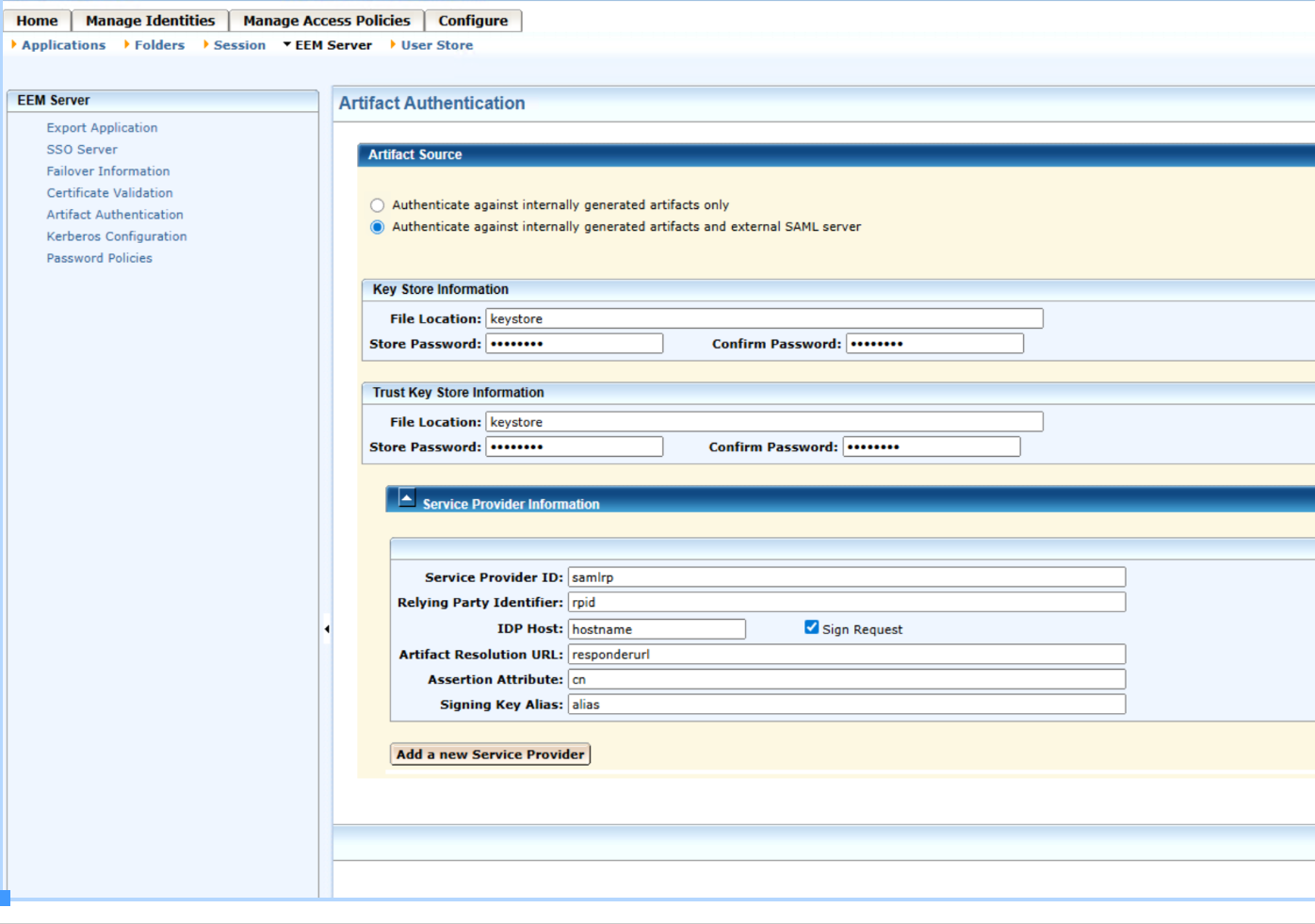

    Answer: For WCC 24.1, the ISO has EEM. We need to use EEM from the same ISO of 24.1, which has support for SAML 2.0.
  4. What are the steps for configuring SSO for WCC? EEM first, then WCC?
    Answer: We can configure anyone as first. WCC configuration is pretty simple. EEM configuration requires a keystore and a truststore along with PingFederate configuration information.

    Answer: Yes. The X509 signing certificate from PingFederate needs to be uploaded/imported into EEM's truststore.
    This certificate is used by EEM to verify the signature of the SAML responses received from PingFederate.
    The certificate should be the one that PingFederate uses to sign the SAML responses.
