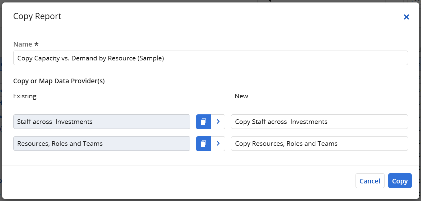

  6. Then, navigate to Reporting > Report Designer.
  7. As this is an out of the box report, in order to edit it, copy the Report with a new name, copying the earlier mapped data providers suggested in the Copy Report step:
