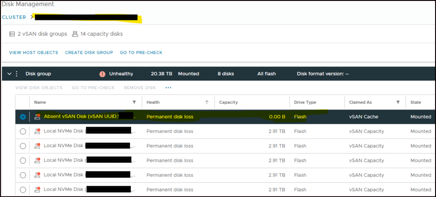

  • vSAN disk appears absent in vSAN Disk Management. (vSphere Client > vSAN Cluster > Configure > vSAN - Disk Management > Select affected host > view the affected disk group containing the absent vSAN disk) with one or all disks in Permanent disk loss.

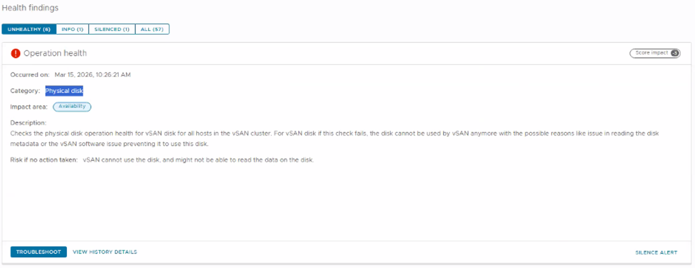

  • vSAN Skyline Health appears with below error,
VMware vSAN 7.x
VMware vSAN 8.x
  • The vSAN disk appears as absent in vSAN Disk management on host1 because the disk has gone faulty at the hardware level.
  • There are no disk alerts in hardware management UI, since the disk is not at all detected at the hardware end.
