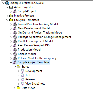

Step 1: Create a new Lifecycle Template from the original project by copying it to the Lifecycle Template section.

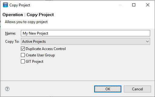

  1. In the Administrator Tool, go to the Lifecycles tab, expand your broker name and the “Active Projects” folder.  Locate the name of the project you want to copy, right click and select “Copy To…”.
  2. In the Copy Project window type the name of the project template you are creating, then click “OK”.
  3. Your new Lifecycle Template will appear under the “Lifecycle Templates” folder.

  1. In the Administrator Tool, go to the Lifecycles tab, expand your broker name and the “Lifecycle Templates” folder.  Locate the name of the project you want to copy, right click and select “Copy To…”.
  3. Your new project will appear under the “Active Projects” folder.

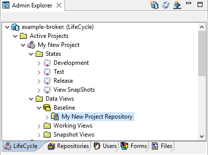

Step 4: Add the new repository to the baseline for the new project.
  1. Go to the Lifecycles tab, expand your broker name and the “Active Projects” folder.  Locate the name of your new project and expand the project and the “Data Views” folder.  Right click on “Baseline” and select “Configure Baseline”.
  2. On the Configure Baseline window, locate the name of your new repository in the “Availale Repository/Vew List”, select it and click the “Add” button.
  3. On the Confirm Add window click “OK”
  4. The Selected Repository List will show that your new repository has been selected as the baseline for your new project.  Click “Close”
  5. Back on the Lifecycles tab, you will now see your new repository listed on the right.
All steps are now complete and the new project is ready for use.
