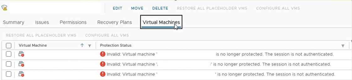

Symptoms:
  • Multiple VMs will be in “RPO Violation” state with the error message: “No host can be used to access datastore path <target_datastore>”
  • Protection Groups gets into "Not configured" state leading protected VM into invalid state.
    Invalid: Virtual Machine 'VM_Name'  is no longer protected. The Session is not authenticated.
