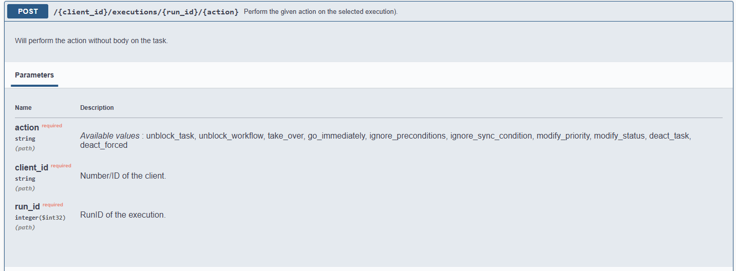

A REST call to take over a task according to the Swagger documentation:
