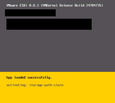

  • During boot of an ESXi host 'hpp loaded successfully. activating: storage-path-claim.' task takes too long to finish.
  • ESXi booting will take more than >30mins.
  • KVM console output

ESXi host is stuck during the boot process with the message activating storage-path-claim
