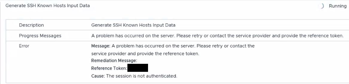

  • Brownfield import of the vCenter fails in the Generate SSH Known Hosts Input Data Stage:
  • Login to VCF Operations UI → Navigate to Inventory → Basic View  → Expand VCF Instances  → Select the instance you require  → Click on Add Workload Domain  → Import a vCenter  → Fill in Domain Name  → Enter in the correct vCenter details to specify a vCenter → Precheck fails with the error:
    "Http failure response for https://<vcfopsfqdn>/vcf-operations/plug/sddc-76/plugin/api/v1/sddcs/imports/validations: 504 OK"
