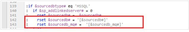

Workaround:
-Add the lines below within the Process tab of the  workflow PCK.AUTOMIC_UTF-8-MIG.START
1)
Lines to be added:
:    rset &sourcedb# = '[&sourcedb#]'
:    rset &sourcedb_mq# =  '[&sourcedb_mq#]'
2)
Line to be added:
3)
Line to be added:
:    rset &sourcedb_mq# =  'UC4_SOURCE.[&sourcedb_mq#]'
Then, execute the migration workflow.
