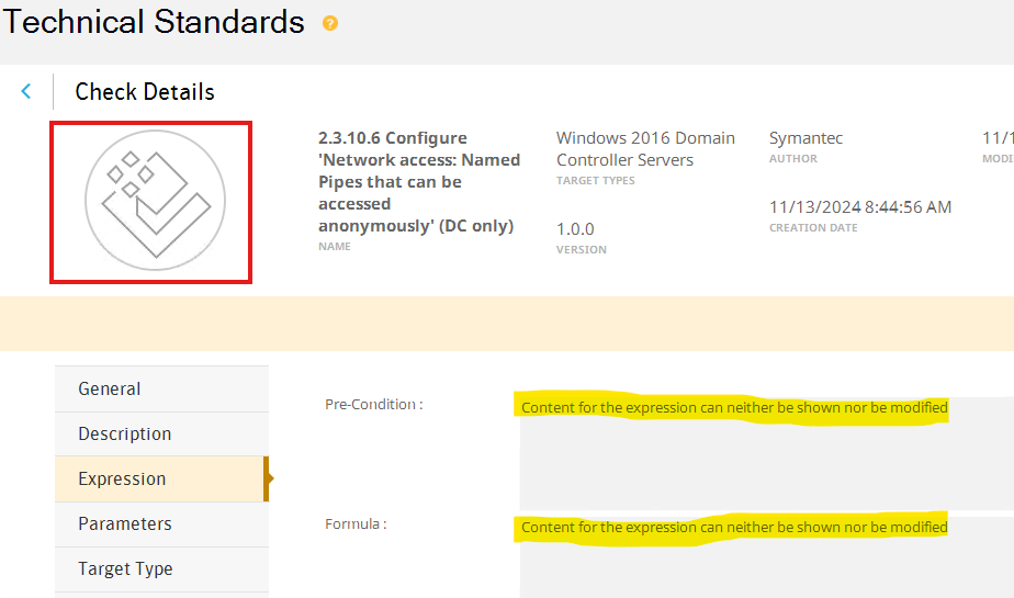

Below is an example of a 'complex check' in CCS.
(Note the symbol of the check which denotes it as being a complex check, and also information that complex checks cannot be shown or modified)
