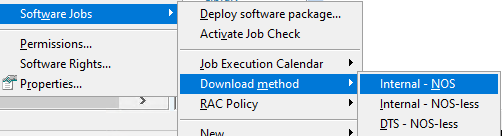

1- A SD Job is sent to an Agent. And Agent Download Method set to "Internal - NOS"
2- Agent could not access the Microsoft share or NFS share and switch to "Internal - NOS-less"

We have the problem with following settings :
Agent : Agent Download Method set to "Internal - NOS" and Agent has to switch to NOSLESS because the network share is not accessible.
