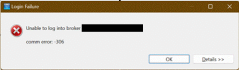

Comm error: -306 from client on the broker machine
Article ID: 419442
CA Harvest Software Change Manager CA Harvest Software Change Manager - OpenMake Meister
After upgrading to SCM v14.5.01, when testing the SCM Workbench and Administrator Tool applications installed on the broker machine, we were unable to connect to the broker.
