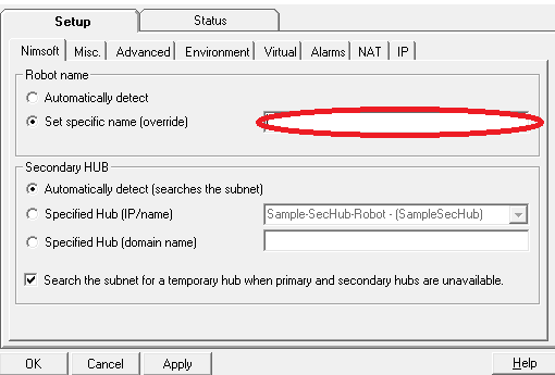

  • Change the robot name on the hub robot controller probe (or in the robot.cfg file).
    • Change in the controller IM config:
