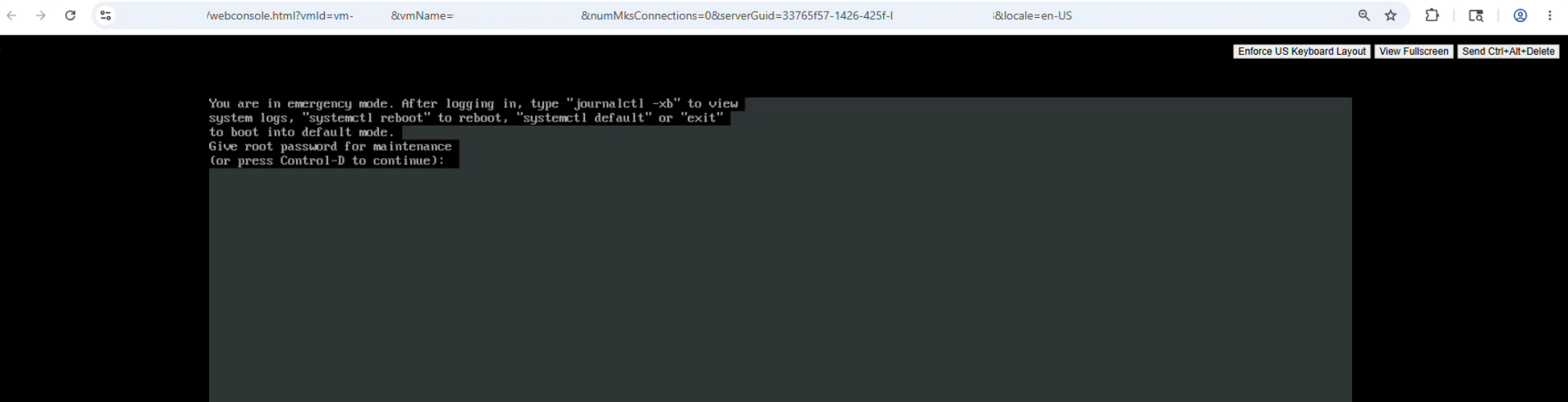

While manually powering on the virtual machine on the DR site on the isolated test network shows that the virtual machine fails to boot and enters emergency mode
Engage guest OS team to validate why the OS is failing to boot.
Because the recovery VM is a replica, the issue may originate from the source itself. Schedule a maintenance window and reboot the VM at the production site. Verify if the Guest OS boots successfully and if VMware Tools initializes correctly. If the production VM also fails to boot, or if the issue persists solely at the recovery site, engage the Guest OS team.
