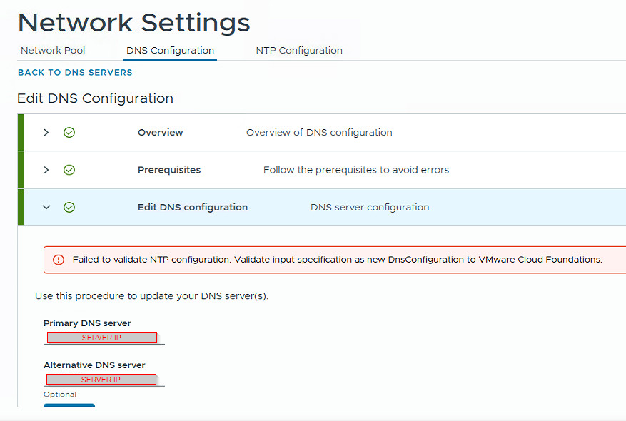

Adding or Updating DNS server configuration on SDDC Manager fails with "Failed to validate NTP configuration. Validate input specification as new NtpConfiguration to VMware Cloud Foundations."

  • DNS server configuration through SDDC Manager fails with the error:  "Failed to validate NTP configuration. Validate input specification as new NtpConfiguration to VMware Cloud Foundations."
