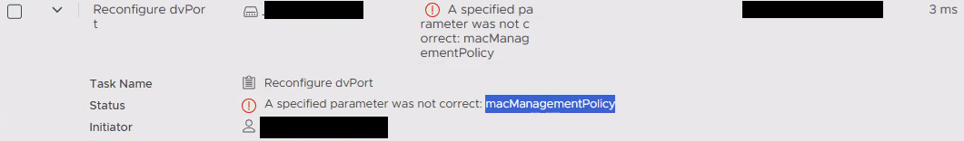

  • After a manual change from the vCenter UI on the HCX extended network (DVS portgroup) and/or the NE VMs' network, a network outage happened.
  • Trying to unextend the network failed, and using the force unextension, the network was successfully unextended.
  • Post force unextension of the network, you are unable to extend it again, with the following error observed from HCX Manager -> Activity logs:
    Error: VC task task-###### failed on VC https://<FQDN/IP>
  • From the vCenter UI -> Tasks:
    A specified parameter was not correct: macManagementPolicy
  • The following error is also observed from HCX Manager /common/logs/admin/app.log
    <timestamps> UTC [NetworkStretchService_SvcThread-253, j: #########, , TxId: #########-####-####-####-#########] WARN  c.v.v.h.n.i.AbstractJobInt- Exception in NetworkStretchJobs:ApplianceConfigCallbackJob. Reason : VC task task-### failed on VC https://<vCenter FQDN/IP>
    <timestamps> UTC [NetworkStretchService_SvcThread-253, j: #########, , TxId: #########-####-####-####-#########] WARN  c.v.v.h.n.i.AbstractJobInt- ApplianceConfigCallbackJob failed in state WAIT_FOR_VC_TASKS. Error: VC task task-### failed on VC https://<vCenter FQDN/IP>. Retry attempt: 0
    java.lang.RuntimeException: VC task task-### failed on VC https://<vCenter FQDN/IP>
    Caused by: com.vmware.vim.binding.vmodl.fault.InvalidArgument: A specified parameter was not correct: macManagementPolicy
