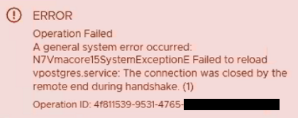

End users experiencing issue on Live Recovery after updating vCenter Certificate
ERROR
Operation Failed
A general system error occurred:
N7Vmacore15SystemExceptionE Failed to reload vpostgres.service: The connection was closed by the remote end during handshake. (1)
Operation ID: ########-####-####-####-######c8924a
