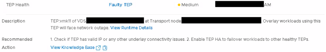

"Faulty TEP" alarm is present in the NSX manager for one or more ESXi host transport nodes

  • When workloads are moved to ESXi transport node the TEP (Tunnel Endpoint) status shows tunnels towards Host and Edges as down.
  • NSX manager report 'Faulty TEP' alarm for that vmk interface.
  • The host may have BFD session UP with other vmk interface i.e., both vmk10 and vmk11 may not be affected at the same time.
  • Vmkping from affected vmkernel interface is failing.
